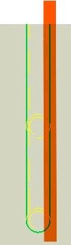

    I'm trying to select the below shown Silhouette (Highlighted in Orange) via API, it is a tube component and the drawing view is currently in top view.

I found the problem in which some forum threads says that the Silhouettes might not be loaded properly. Then I hovered over the Silhouette manually using my mouse and then used the above code again. Surprisingly, it works. But I can't do this everytime because I'm automating this drawing.
