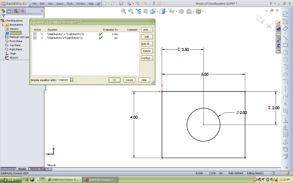

Dear Deepak,
Thank you for offering to help.  It happens in all applications and a freind of mine has the same issues.  What seems like it would be straingt forward, is not.
Here is a simple example, sketch a 5" X 4" rectangle, put a 2" diameter circle approximately in the center of the rectangle.  Assuming that you have Smart Dimensioned the sketch items, dimension the center of the circle off of the bottom and side of the rectangle.  Use equations, modify these centering dimensions, i.e., make the vertical centering dimension 1/2 of the height of the rectangle.  Do the same to the horizontal.  Then change the rectangle's dimensions, in theroy the circle shoud stay centered inside the rectangle.  It does not for me or my friend, we have competely seperate systems and versions of SolidWorks.

You need to delete the coincident relationship between the circle center and both dashed lines.

Larry,
An example file is attached. This is as per your procedure. I am using SW2009 SP5.0.
Please check this file if it works as expected.
Hope it helps!!!
Rajat Jain
SF
SF 2011-01-09
It's working here.
no matter how many times I change the length and width of the rectangle, the circle stays in the middle.

I am having the same trouble.  I have a complex drawing with 23 equations.  It used to work perfectly.  Now, all equations get ???.  I made a new part, added one equation that says "test"=2.  This still will not evaluate.  Is there a global switch to turn on/off equations?

Same computer setup, upgraded to SW 2011 sp4.
For some reason, the equations just do not work at all.
JK
JK 2011-11-29
This has happened a few times to me and fellow employees,
For us, a restart, fixes this problem.

TG 2011-12-13
