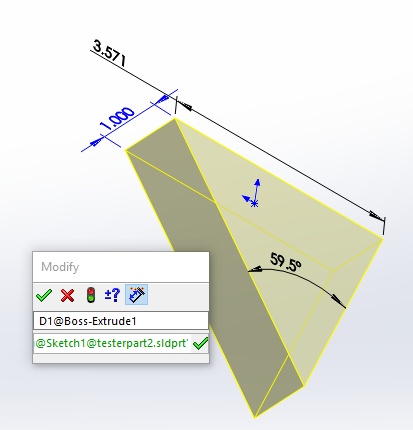

I've recently upgraded to the 2015 Student edition of solidworks. Myself and a number of other students have had their assemblies break due to equation errors. Solidworks is no longer allowing equations to accept dimensions from another part using this sort of syntax:
D1@Sketch1 = D1@Sketch1@Part1.Part
Equations that worked just fine prior to the update are now reading back as syntax errors. I was wondering if anyone else had experienced this error and had a solution to it. I threw together a quick example and have attached the image. In the example I am trying to reference an part in the same directory as the part I am editing. The green check mark shows up however when I select OK the dialog says the syntax is invalid.

have you typed in the equation manually? or have done this in an assembly?
It seams to work fine on my machine

I also have the 2015 student version (can't tell you what build - it's at home and I am at work), and I seem to have the same problem as the OP. I'll try again tonight and will post my results.
One difference is that I have the file name extension .sldprt, not .part.

I'm manually entering the equation it in the actual part file. I've tried both in the equation manager, and in the dimension dialog directly.

I have SW Education Edition Academic Year 2015-2016 / 2015 SP5.0.
I note that Ashwin used single quotes in his formula  ' . I tried that and got the same result.
I also tried double quotes "  , and got the same result.
Then I single-clicked instead of double clicking on the dimension and I got the simple one-line text entry box. I entered ="freddy@Sketch1@testerpart2.sldprt" with the double quotes and the current value from the other drawing was inserted. The insertion was only the value, though. Changes to testerpart2 will not be reflected.
Images attached.
It's a start, but not what I want.
