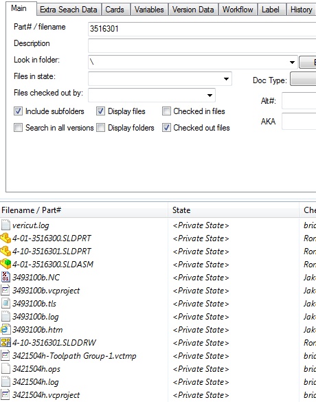

I recently upgrade to 2016 SP3 and still see the same problem in searching.
So this bug still needs to be fixed. Luckily, it only effects me as the site administrator.
comment imagecomment image
