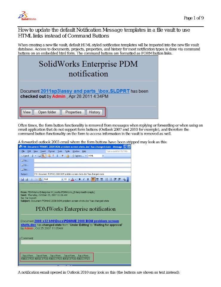

1. I'm not entirely sure how it works, but our marketing guru considers html code his second language so he was able to edit the e-mail template to include it.  I'm assuming it's just a standard line of code linking the folder outside of EPDM.  I've attached the pdf that talks about how to edit the e-mail template.

Yes that is how it works.  We have links within the notification e-mail itself that will pull up a new e-mail message so all the approver has to do is click send.  It's been a while since I've worked for a company with stricter quality policies, but for our ISO standards, this e-mail approval is accepted.
This is the notification e-mail everyone gets.
This is the e-mail that opens when clicking on the changes approved link.  Denied is similar but says, "I am denying the changes for ECO.... for the following reasons:"
