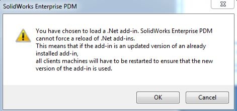

Ajay did you add this as a “new add-in” or as a “Debug Add-in”. If you loaded it as a debug then you need to remove it from the debug add-in dialog. If it was loaded using the new add-in then when it was loaded you would have gotten the attached warning. From what you are saying you have restated all the server services but haven’t restarted the client machines. I would suggest reloading the newest add-in and restarting the client machines.

SF 2011-06-29
Hi Ajay.
Restarting is not strictly necessary.
Open the administration tool.
Remove the old addin
Add the new addin
You can open taskmanager, then kill the explorer process.
Then launch explorer again by clicking File -> New Task (Run...) and then type explorer.exe
Voila. No restart
