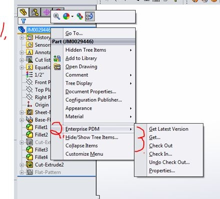

When in a part, assembly, or drawing, I always right click in the tree on the part, assembly, or drawing and "check out", "check in", "get latest version" etc. In 2014 these options were at the top level, 2015 has them indented - must click the "Enterprise PDM" menu, scroll over and down to the various EPDM functions.

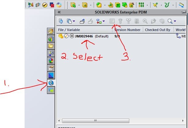

The other hassle is also when in a part, assembly, or drawing. When I click on the EPDM button to edit properties or do anything else vault related, I must again select the part, assembly, or drawing before I can do anything whereas 2014 would assume you wanted to edit the top level part if nothing was selected in the drafting window.
Anyone else seeing these same things. Everything seems to work, it's just frustrating that this version adds so many actions to do the same function.

I am told the reason for this was to improve EPDM performance.  Previously, in older versions of EPDM, when right clicking in the feature tree, task pane or even on the model, EPDM would check the SQL database, every time the right mouse was clicked.  This becomes troublesome in replicated environments and caused a great deal of slowness.  We removed these options from our right click menu in the registry and the speed from the client side improved by not having EPDM check the SQL database every time a right click happens.
SF
SF 2015-02-19
So I am presuming by indenting the menu, that it will only check the SQL when sliding into that submenu.
MW
MW 2015-02-19
Ok, so a "normal" right click does not query the SQL database, it only does when indenting into the EPDM submenu. That makes sense for me, as I did already experience the performance issue in replicated environments.
Is this also the reason why one needs to select the file again in the EPDM task pane tree before checkin in?
I work around that by right clicking the file in the EPDM tree and then select check in ( or check out, change state) from the context menu, works fine and quick once you are used to that.

Mike provided the exact reason why we indented the menu.
