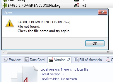

Using IEdmVault5.BrowseForFile() function in EPDM 2015 SP4 does not return files that aren't locally cached. I know this worked on 2014. Anyone else seen this?
I'm using 2015 SP2 and I cannot reproduce the issue you are having. Whenever I click on a file in the browse window, it automatically gets the latest version. This happens with and without the PDM setting to automatically work with latest version.
Maybe some code for context would help?
