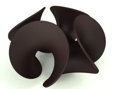

Hi All,
  How to create Enneper Surfaces in Solidworks?
  I have included image for reference.
  Also, in Rhino there is plugin to create Math curves, called "Math Plugin"
  Is there is any addins to create various mathematical driven curves in Solidworks?
  Thanks in advance.
R.Buvanesh balaji.

Is this a shape that you would use to build something? Does it have some interesting geometric properties? I look forward to the answer.

that would be an interesting and probably chalenging shape to make.
there are equation driven curves in the core SW product - I do not know of any add-ins that add to that functionality.

I could not resist trying this out - I did not use any equations, so it probably is not correct, but it looks like you image.

There is no way to create a surface based on a mathematical formula in SolidWorks natively. You might be able to with a plug in, or you could do it in Rhino and import the part.
However, it was fun to model an approximation

Hi All,
  I am able to do in Rhino with "Math Plugin"
  Snap shot, Rhino & STEP files are included.
  "Math Plugin" can be downloaded from : http://www.rhino3.de/_develop/__v3_plugins/math/
   Equations for Enneper 2,3,4 & for various surfaces are from :   http://rhino3.de/_develop/__v3_plugins/math/library.shtml
   Thank you all for the help.
