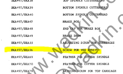

We've just 'upgraded' our tenoner and got an old Wadkin EKA.
It's a great bit of kit but unfortunately it's been a bit abused.  The bolt to secure the screw which locks the heads together is broken and I have no idea how it should function.  The end piece has snapped off and is missing.
Here is a snip from the manual describing it's use.
I think I've identified the Part No. but I don't think spare's are available so we'll have to get one made.  I'm not really sure how it should look.
A clue may be in the Part Description (If I have identified the correct part)  SCREW FOR VEE STRIP
