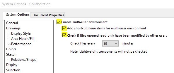

I have one computer (out of about a dozen all running SWX 2017 Professional (Win 7)) that when I check the Enable Multi-User Environment settings box (Sys Options, Collaboration), click on OK, close SWX and reopen, the setting box is unchecked.  Most of the computers were all built around the same time several years ago though this particular one is definitely the oldest.  None of the other computers seem to have the problem.
I saw other postings of similar no-save settings issues but did not see any solutions.  Any thoughts?

Does the user on that machine have the PDM Client add-in turned on?  If so, turn it of on both the left and right side of the Add-ins window.
When the SolidWorks PDM (standard or pro) add-in turned on, then the collaboration settings are turned off when SolidWorks launches.

Turing off PDM clears the issue, but I still want a shortcut to change file read-only status. This helps when I want to maintain ownership on PDM, but don't want the local machine to save (or painful rebuilds)
