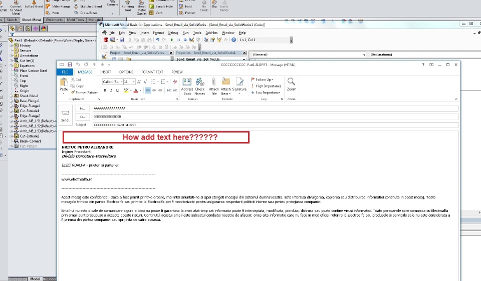

Hi,
     I try to make a macro to send mail from sw with outlook...
How can I add text there?? ...with:  myItem.body = "" disappear signature
