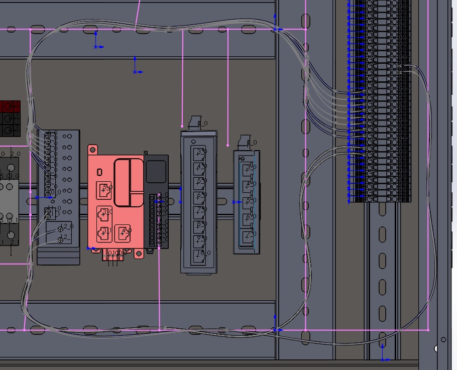

Hello,

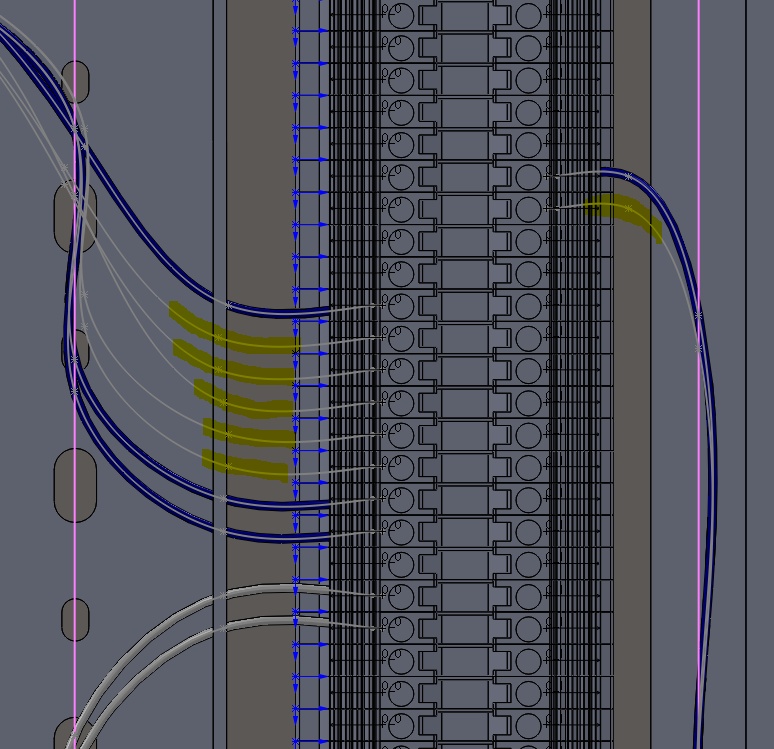

When I click route wires, some of my wires route correctly and I can see the 3D wire but some wires don't even though their 3D sketch wire path is still there. Why are the 3D wires not being created even though the sketch path is already there? I took some screenshots and highlighted what I mean by some wires not wired and the path is still there. I need these 3D wires for generating reports for wire length.

Check if your route contains just wires or cables and wires.

The top things that I check:
Does 3Dsketch produce results for all the paths?  If not, you may have a schematic issue to iron out, making sure everything is actually connected in the drawing.
Is your EW_PATH sketch too far away from the points or other sketches?  Adjust the routing parameters to give yourself a little more distance so the routing points can "see" the path to run on.
Is your bend radius to do the route too large?  Sometimes the wires are set with a bend radius, and if the bend radius is set too large, the wires will choose a path that can't accomodate the bend radius you've given it and they won't route.  You can fix this by either lightening up the bend radius diameter to 1 or 0 for that wiretype.  Or make your EW_PATH a little further away from the routing points.  It sounds counter-intuitive but actually making your EW_PATH TOO close or TOO tight will make the turns too tight for the bend radius.
Do you have segregation rules that are maybe preventing wires from finding a viable path?

Perhaps some of the bend radius' are too tight for what you have specified in the wire properties... Try using the spline control polygon and see if that helps when you adjust each individually.

Haha, yes, I got a little long-winded there, for those specific wires it looks like the left side of that component is running tight to the path and the radius needs some massaging.  Spline control is a good call there.

I see you gave more specific options. I didn't read your reply - which I should have. I was staring at the two pictures, at the points and hoping they weren't constrained to some of the edges and associated items around them. HA
