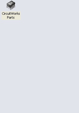

Not CW useer but in 2010, if you go to Design Library/ SolidWorks Content and open the CircuitWorks folder. If 1st use you have to designate a folder to place the content.
I turned on Circuitworks and found the folder. Only a few parts.
I guess my next step is creating a library of the parts I am using and go from there.
Just trying to relate the XML file and the parts and how the inter-relate.
Tim
If I hover over the attached image, it tells me to CNTRL + click to down load the zip file.
