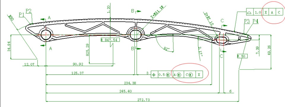

Hello every one,
I’m sorry for posting this question again.
I don’t undertsand about the precedence of reference datum in this drawing.
I asked my colleague and he just say it obeys principle of MMC.
I wonder without  regarding to MMC, is there any diffrence if I change the order of reference datum  in tolerance frame.(X,A,C to A,C,X)

My Answer would be no since this is a 3D profile tolerance and therefore applies to the entire surface with respect to the 3 datums that completely lock down the part in 3D space. Having said that I don't see where the datums are defined in this drawing. Usually they look something like this when given off a planar face or an axis.

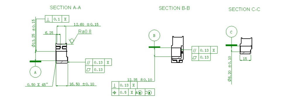

@Brian Brazeau, thank you. The datum are define in sections in the lower part of that picture. I read ASME Y14.5 M-1994, it seem have difference for order of datum, I just only don't understand how to apply that difference into manufacturing. For example, in your picture can I change order of A and B datum without affect of the
quality of product?

Do you mean this as definition of Datum A for example? If so, I'm not sure that the datums ABC properly set up your part.
In the example above the the geometric symbol is True Position not 3d Profile. It is also a lathed part which allows setting up datums different than prismatic part.

Those are defined as A, B, C datum. I am concerned about frame reference. In the original picture, with the profile tolerance the datum precedence is X,A, C  and for position tolerance is A,C, X. I wonder the frame reference which are setup in those cases are same or different.

I suppose they may be different in this case, but I'm not sure the true position is even used correctly. Wouldn't the true position be more useful attached to one of the 2 diameters associated with the slot/plane that datum B is attached to? 3mm is just a linear dimension. Is this a case where you are trying to define the location of the entire slot? If so (see below)

The difference between the two cases is the order in which the datum's are picked up on the CMM. If the part is perfect there is no difference.
In this case, if "A" comes 1st then any error in axis of "A" with respect to plane "X" has a smaller effect on true position tolerances. If "X" comes 1st then any error in axis "A" with respect to plane "X" has a smaller effect on the Profile tolerance. However as I said above 3 mm is just a linear dimension in this case. I would think you would want both to be XAC. It is also god practice to have only 1 pick up per part if achievable. HTH.

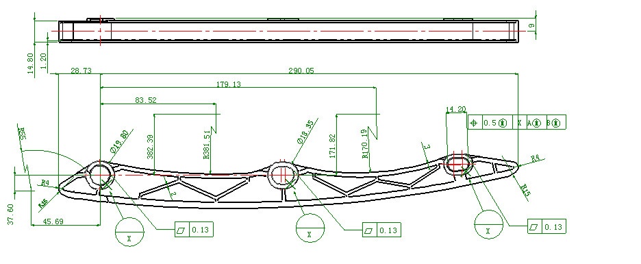

This is the best I can do. 6"  is the print dimension. This is because any point the cmm picks-up with regards to the feature being checked will be skewed. But again the 3mm dimension is not a dimension that should have a true position applied to it.

NN 2018-05-02
Thank you so much, @Brian Brazeau. I think 3 should be replaced by 15.35 as described in picture below.
