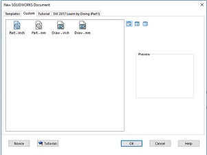

Not creating a new template. I want to make changes in existing template. That mean my drawing template font size is small I want to increase the size.

from the open dialog, change the file type to template. It will automatically go to the directory specified for templates in the system options Looks like you've added a few other folders so you may need to navigate to the right one as it will go the the folder at the top of the list. Open the drawing template. go to document settings and adjust your font size(s). save.

Open a new document with the existing template. Make the font changes you want. Save as drawing template under the same name.
