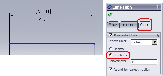

I have one doubt. Is it possible to do some additing or addition with the dual dimensions?
Particularly I have to work with the Dual dimension as inch Units with Fractional display.
Thanks in advance..

Jitendra does the attached pic solve your issue. To get this, select the dimension, go to Other tab and change the settings as required.

The mentioned pic is only about the Main Dimension changing to Fractional format.
I want main dimension as metric with secondary dimension as inch with fractional representation. Plus I want to add some text to the secondary dimension as well.

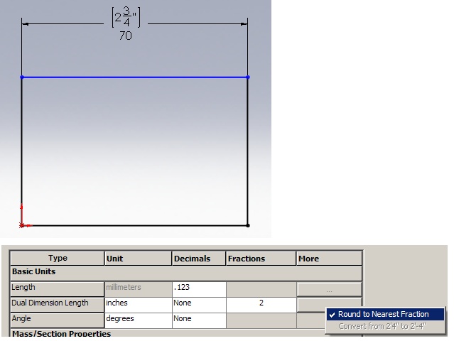

<p>Jitendra wrote:</p><p></p><p>I want main dimension as metric with secondary dimension as inch with fractional representation.</p>
You can set this in the Document properties under unit settings

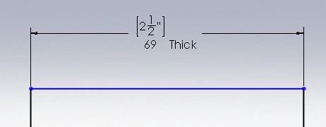

Deepak,
Thanks a lot for ur post but what i am looking for is concatenation of dimension and my own text. Ex: in your uploaded pic, it shows 2 3/4" whereas I need 2 3/4" Thick to be shown, i.e. dimension + MyText.

I doubt if that can be done but you can have the test with the main dimension.

Thanks Deepak,
But I need it with Secondary Dimension.
