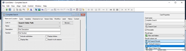

Folks, still somewhat new to SW PDM, but getting better with use
Question, as shown below, I generated a new Search Result Column Set, which is highlighted.
I cannot find a way to edit it to make changes to the columns that I created when I made this set.
If this is clear enough, how do I edit this existing column set, or do I need to make a new one and set it as the default...
And maybe there is a better way to approach this...
Thanks!
Brian
This turned out to be a permissions issue, although I changed the "columns" set, how it was accessed
thanks though for response

JF 2021-04-08 Best Answer
you need to go to the "columns" node in the Admin tool to edit the column definition - can't do it from the card editor.
