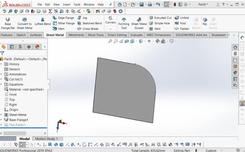

It looks like there's a bug in the Edge Flange tool in 2019 SP4. Can anybody replicate this? I have attached a video that should make it crystal clear, but basically you can create an edge flange on a curve, but only propagate it in one direction to a tangent edge. If you try to select the other direction it fails.
Is this only in 2019 SP4? I have attached the sldprt, just for anyone to verify. Is this also a problem in other versions? It's easy enough to replicate the part to check.
