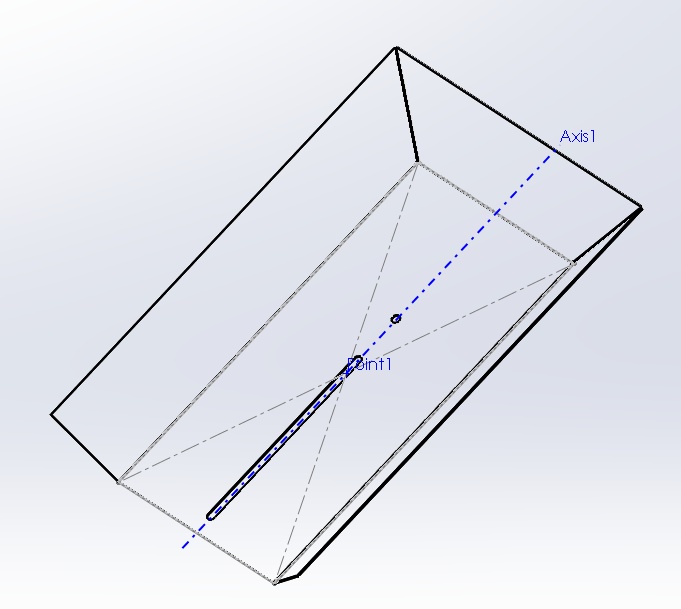

I need to make two edge flanges to use for riveted lap joints on the following tray:
None of the demonstrated methods (in training videos) provide a working solution for the compound edge joints where the 45° sides of the tray meet at the end. The flanges created end up at odd angles and or overlap the material on the opposite sides of the joint, and do not account for the need for the edge flange to have angled "sides" so the tray can be cut from a flat pattern. The lap joint flanges do not need to "seal" the joint. The tray is aluminum, and our sheet metal fab vendor does not have ability to weld the corner joints. Any help appreciated.

I attached an example.

My example is a compound angle. Yes you can build this in 3D.
1 Build the part, my example is a mitered flange
2) add the flange as an offset flange
2a) adjust the dimensions for offset and flange profile to suit while checking your flat pattern.
2b) EDIT the flange profile to suit
2c) you will need to edit the flange profile line relationships inside the sketch i.e. delete the vertical relationships and add your own relationships inside the sketch.

Yes, this is what I am trying to accomplish. How did you create this? Do you have to calculate the flat shape vertices manually, build the shape, and then add the bends, or can it be done in "3-D space" and then made into a flat pattern? If you happen to have your part build file for this component, would you be willing to send it to me?

Sort of right, but the corner joint is a compound angle in my part, and SW doesn't seem to be able to create an edge flange that is the correct angle or offset.

I am not sure of what you are attempting. Perhaps something like the attached? Attached model is in SW2014 SP5 format.
