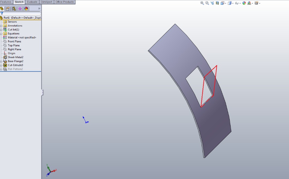

So I'm not so sure the correct description is "edge flange for internal edge", but I'm hoping someone might be able to shed some light on something for me!
I am modelling a part that may or may not NEED to be a sheet metal part, but I dont see why It cant be modeled using sheet metal. That said, I'll admit to not having used sheet metal all that much and so I wanted to model it using sheet metal as a bit of a learning exercise.
Below is a screen shot of what I am trying to do, the base flange is a piece of plate rolled to a radius. I then want to make what would effectively be an edge flange from an edge of the cut out region to for a tab, bend out from the original plate. So far, I have tried:
- edge flange (I assume can only be used on external (straight) edges)
- sketched bend, which sort of worked by adding a base flange to the 'bend edge' then beding that. This however, results in 2 bodies...
How do you do this? Do I need to use a form tool? Can a swept flange do the job?
Normally I would say that there isnt too much I cant do/figure out in SWrks, but sheet metal is a little alien to me and this one has me stumped. I hope its an easy solution that makes me look stuipid!

SF 2012-07-13 Best Answer
Hello David,
I can give you one way to create this, that is by using forming tools from the design library. But unfortunately, you will have to create a one tool with your dimensions by yourself.But, no need to worry, as its fairly easy, as its well explained in the Solidworks Help. You can find step by step method for creating that. This will definitely work out. At the same time , I am also interested to know if there are any easier ideas. Lets hope some experts in sheet metal can help.
Vijil
SS
SS 2012-07-13
David,
To my knowledge you cannot add a flange off a curved face. The face has to be flat. So, I tricked solidworks into doing what you want. I took the main arc of the base flange and broke it up at the beginning and end of the cutout. Then, in the gaps, I put very short (0.005") lines to represent flats. By adding the flat sections, there is now a flat face to add the flange (even if it is extremely short).
Then, I unfolded the part to add the cutout (make sure the cut takes goes up to the flat tangent of the small automatically created bend). After I folded it back up, I added the edge flange.
Not exactly pretty, and maybe someone else does know a better way, but it did the trick. You'll also find the flat pattern on the drawing has several extra bend lines (from the automatically inserted bends due to the flats), but you can hide the extra ones and only keep the notes you need.
As a double check, I modeled a second part using a solid arc of the same thickness/k-factor/radius, and the flat pattern length was exactly the same. This will probably not be the case the bigger the part, the thicker the part, or the size of default radius you use for the automatic bends. But you can make the flats as short as you want to fix that.
My file is attached. Hopefully this helps.

Thanks guys,
Vijil, if I can get ten mins free I will try the form tool method out of interest.
Sean, cheers for your help also, I think that is the simplest way of doing it. I have actually used this trick before, but when starting this model, was wondering if there was a 'proper' way of adding this feature.
