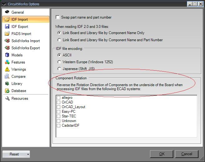

Has anyone had any luck in having parts modeled in solidworks use different origins than that used in the ECAD software?  The help files for circuitworks state that if you put a lone sketch point in the component outline of the 3d model, that circuitworks should use that origin.  I have added the sketch point to the 3d model of the part and circuitworks appear to recognize that the part "moved", but then that change is not applied to the solidworks assembly when I build the model.
What am I missing?
Any advice would be appreciated...thanks!
