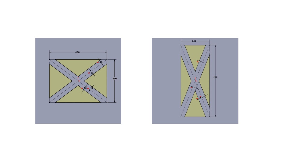

I plan on using a rectangle lightening pattern quite bit. I made it in a way that it can scale to any height or width I want. The only problem I have is it takes a little while to make. Is there a better way to make it? Can I copy and paste it but keep all the dimensions?

GS 2018-05-03 Best Answer
Yes, you can copy and paste sketches.  They'll maintain dimensions and relations within the sketch, but you'll need to re-apply any relations or dimensions to entities that don't belong to the sketch (such as the origin, model edges, other sketch lines, etc.).

You could make them a library feature:
2017 SOLIDWORKS Help - Creating a Library Feature

Can you create a block of the sketch?

Here is an sldfp file that is totally amendable to changes as you need them in your model. T
he library feature is under defined enough to manipulate the location in your parts.
Choose the override option for dimensions and you can change the horizontal and vertical size of the cut out as you need to.
