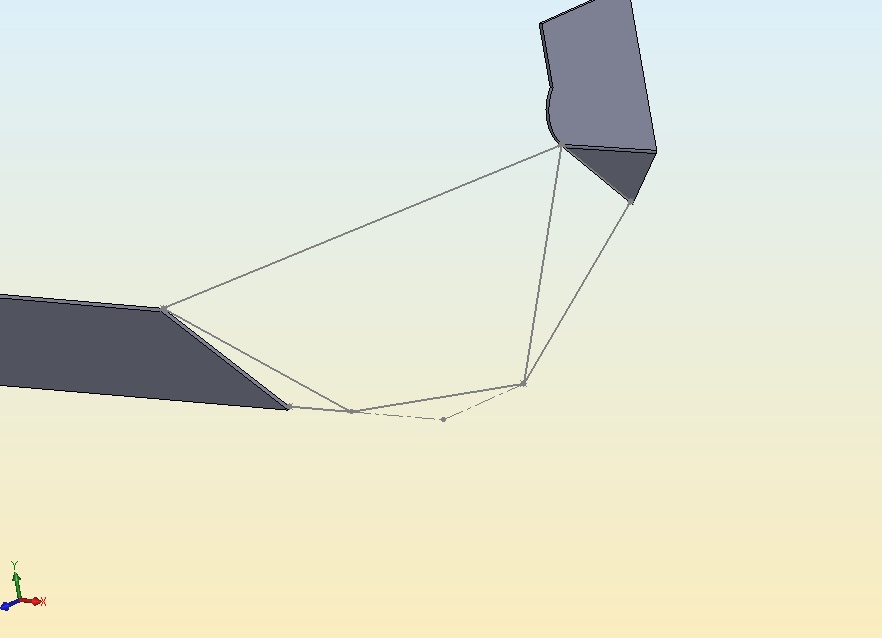

What would be the easiest approach to create a sheet metal piece with 2 bends to add to this assembly. I have a 3D sketch of showing the geometry the sheet metal piece needs to be.
create the 3 surfaces depicted in sketch
knit the 3 surfaces
thicken
insert bends.
i'm using 2013 so i can't directly use your example.
