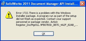

Anyone out there tried installing EDrawings 2011 on a computer that doesn't have SW?  I was sucesssful running the installation, but when I open a drawing, I get an error that tells me I need to install the Solidworks Document Manager.  When I download and install the Document Manager, the installation fails with an Error 1722, Problems with the Windows Installer Package.  Without the Document Manager, EDrawings prints a warning message across all of my drawings.

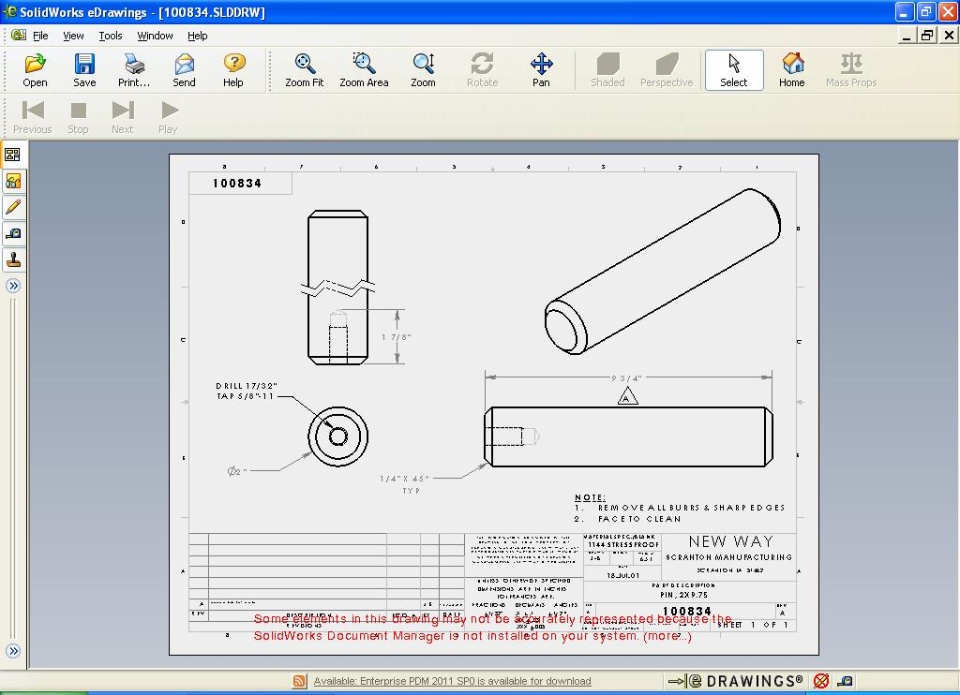

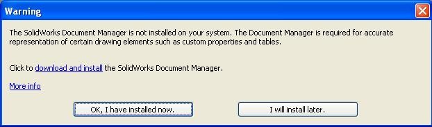

ETA - Here are the installation dialog box, error dialog box and one of the drawings with the watermark on them (red text). I have opened SR #1-1859172141. I'll post whatever news gets sent my way.

"In SolidWorks eDrawings 2011, we now require the “SolidWorks Document Manager” for some of the drawing capabilities. I have not seen this related to a watermark when printing from eDrawings 2011. To rule out any such issue, I suggest you install the following:
Microsoft Visual C++ 2008 Redistributable SP1:
http://www.microsoft.com/downloads/en/details.aspx?familyid=2051a0c1-c9b5-4b0a-a8f5-770a549fd78c&displaylang=en
SolidWiorks Document Manager API:
Simply download the file when prompted (the prompt appears when opening drawings)
You can then use the above downloads and install on other machines. ). If the above procedure helps resolve the watermark issue, let me know so I can report it to the development team promptly. If the watermarks persist, you might want to send the files to your local reseller of SolidWorks (Tridaq) as they can decipher the possible causes (i.e. Educational edition, personal edition , or out of date watermark). Thank you. "
This solutions seems to have worked for me. I downloaded all 3 files and install the appropriate file to the appropriate OS. Then install SDM. I hope it works for you as well.
