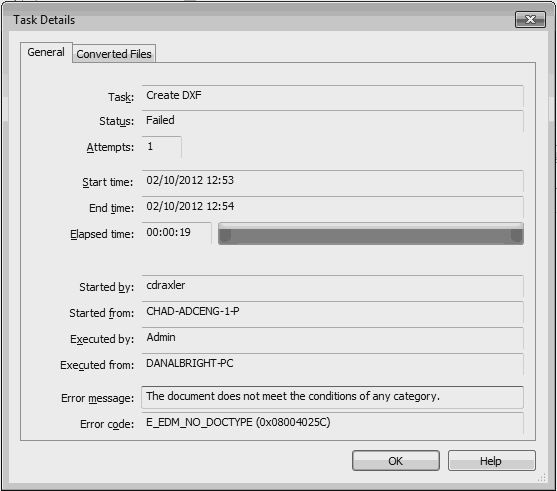

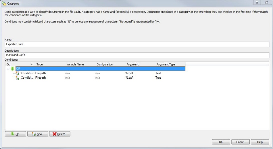

Our output dxf task sometimes fails becasue "does not meet the conditions of any category" when the only condition is that it ends in .dxf
The task works about 95% of the time, and again since the only condition of the category is that it ends in .dxf which is a part of the task itself, how can it not meet the condition of the category...?

For testing purposes, have the task also create a copy of the dxf outside the vault. See if it creates this copy when it fails to create the one in the vault. If it does create the dxf outside, try manually adding this file to the vault.
SF
SF 2012-02-13
Chad,
Is the task running in a specific machine or executed from where it is triggered ?
