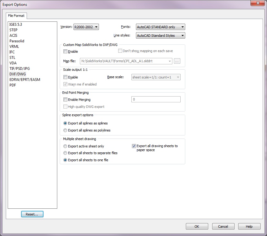

I recently created my first drawing in Solidworks,
Than I exported dxf, I choose the following export settings,

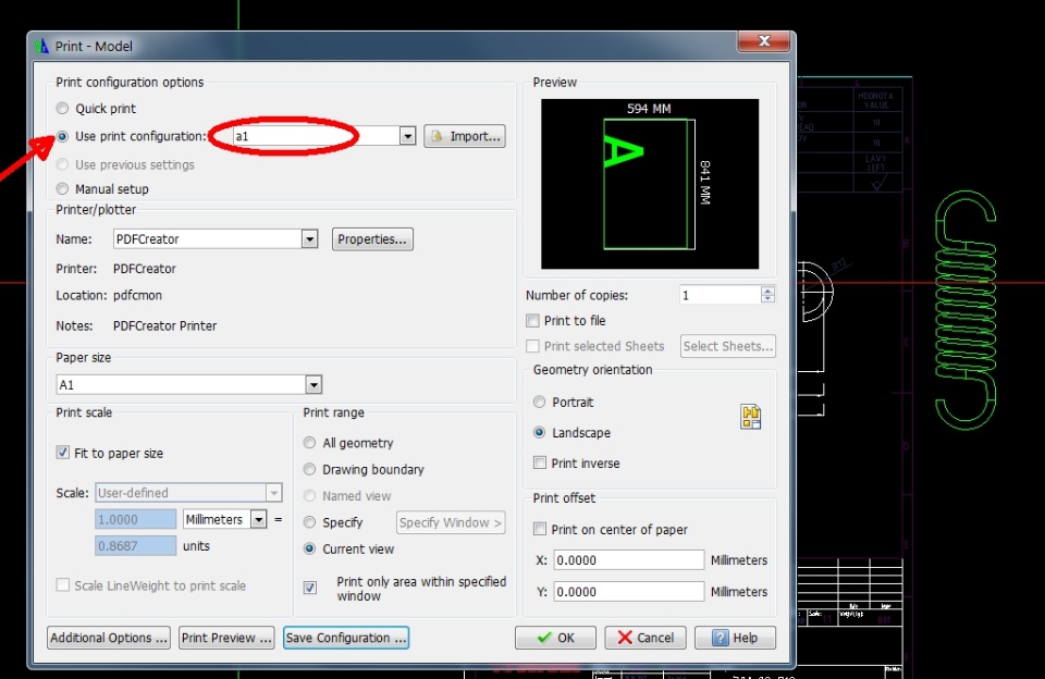

but I am facing different issue,
actully when I export the drawing from solidworks my drawing broder does not fall fully in paper space in Dxf file.
so the issue is with solidworks settings and not with draftsite.
Please see the test file.

I have the dxf/dwg export options set to:

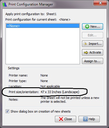

the file created has sheet1 (paper space) set to imperial units:
the following paper space sheet is metric:
and of course sheet 1 is off the paper since it is off by a scale of 25.4.
What is driving this setting?

You haven't changed your units to mm in draftsight which is why the plot size still reads "23.39x16.54 inches".
DXF files do not contain metadata for setting the units in the program that it is being opened by, so the drawing is coming in as 594x420 (no units) and draftsight is saying "I'm going to just assume those are inches because that's what I'm set to recognize".
Also I opened your dxf file and it looks like your border is much smaller than the paper size so in the lower right of the box below you should use the print offset command to possition it where you want on the paper.
