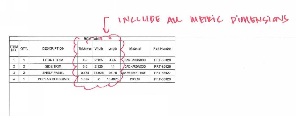

Ok, I have a customer and they wanted to display both inch and metric units in a bill of materials does anyone know if this is possible?  I went into the part itself and turned the dimensions to duel, and also went into the document properties under units and tables but still no luck.

Create extra properties in the part(s) for metric dimension and multiply them with a factor for converting Inch into metric. You'll have to use equations to get the required values. No insert more columns in the BOM and link them to those properties.

Yeah I was thinking that that's what I would have to do I was just trying to see if anyone knew a faster way, because I'll have to do this to +20 drawings.
