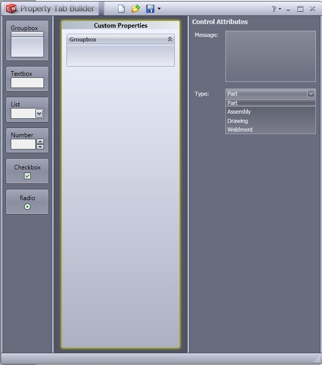

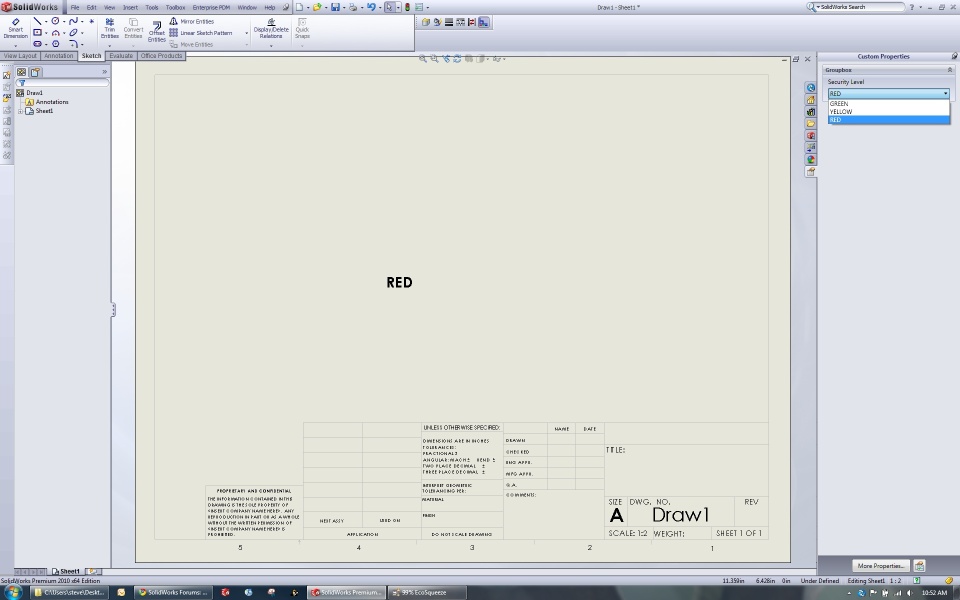

I want to be able to select a value from a drop down manu in my title bar.
As an example... Security level.
I need to be able to select GREEN, YELLOW, or RED from a drop down menu that is enbedded in my title block.
Similar like you select font type or size in excel, But I need to be able to predefine my values.

I would have it be a custom property and have the drop down in the custom property tab in the task pane.

I know I can use the property tab builder to make a drop down manu, but it will only work for parts and assemblies.
I looking for something that is fully embedded inside of a drawing, without external referenced files.

you can make a property tab for drawings also.
I know of no way to but a drop down on the drawing sheet without adding an OLE excel sheet.

You're right. you can make a property tab for a drawing. For some reson whey you go to save as (In the tab builder) I can't select to save
it as a .drwprp.
I only have a choice to save it as .prtprp.
But anyways, if you manually type it in as *.drwprp than it works.
I guess this is the best option, that I have.

You can do all of this in the Property Tab Builder as my screen shot shows. Just make sure you set it to a drawing and then link the note on the drawing to the custom property.

When you start the custom property manager, set it to a drawing.

yes, you need to set the "type" in the property tab builder. and apparently 2010 added a 4th type, weldment. kind of makes me want to model weldments now...
