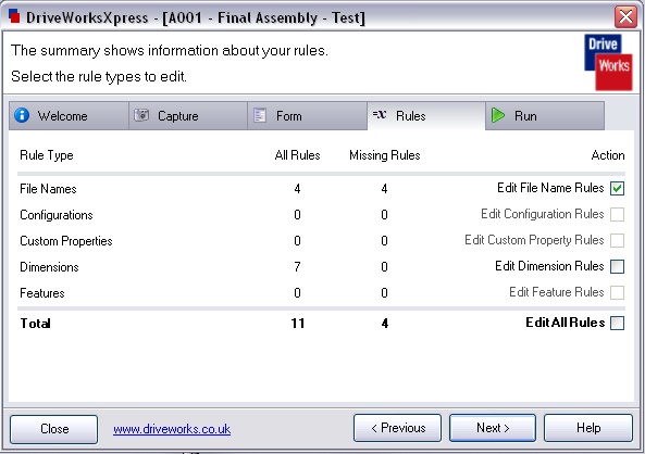

So I've just started looking into DriveWorksExpress.
Very nifty except one major issue for me.
I cant run it unless I specify a rule for the filenames. It comes up that I have missing rules. The problem is I DONT WANT a rule for file names?
It's important for me that the filename doesn't change as I have equations for parts that depend on the state of another part. If the filename changes then it's referencing the old part and gives the wrong value.
I intend on doing a pack and go then using driveworks to drive the new model.
Any help will be hugely appreciated.

Trev, you need to specify the file name rule else it will open last saved model with the same name. And it'll be better to specify the equation in DriveWorks rather than setting in the part/assembly level.
if you want to use DriveWorks, avoid any in-context relation the part/assembly level. Use DriveWorks to specify them

Seems odd that I will end up with the part saved twice, even though they will differ slightly.
I thought that driveworks would work like a design table and change the part itself.
Is there not a way for the output files to be placed in a different folder at least?
Surely the folders are a bit of a mess having multiples of each file?

Not with DriveWorksXpress but yes if you use DriveWorks Solo or Pro, you have lot many options available. You can request for a 30 days trail for DriveWorks Solo

With the full version you can do all this...but this is the express edition, it's just meant to show you the concept.
With this Trial version, you can't specify RelalivePath (folder location), and you can't replace the original model, so, NO, you can't generate without specifying a different filename.
