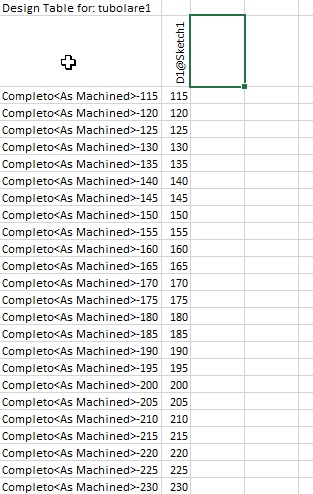

I have 2 parts files, each one have ~50-100 configurations created with a design table in excel. They are simple part, a weldment profile that change in lenght. The design table of the parts drive the lenghts.

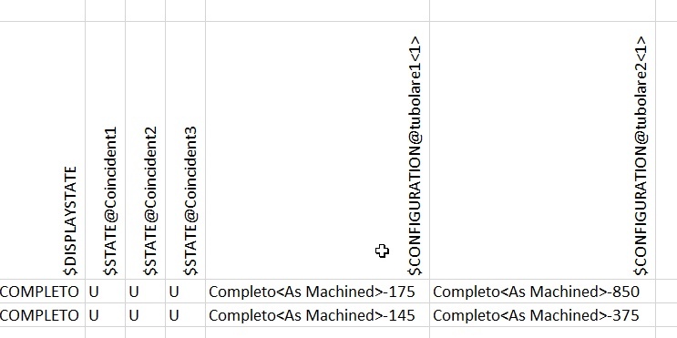

Then i made an assembly with these 2 parts and created a design table with some configuration. I inserted the the column \\\$configuration@
But from excel i cannot select others configurations of part file. The drop down menu report me only the the string (the name) of the column.

part design table
assembly design table
here you see that the drop down menu is empty.
