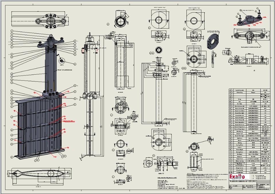

Same for me, love the program but when it comes to drawings and detailing... crisis !
Working on a 'A0' size drawing now with for example 30 views on it, SW seems to be the wrong program for this, please SW programmers change this !!!
I know change to mono drawings is an option to avoid this problem with 'big' drawings but come on it's 2010, I'm sure it can be better.
