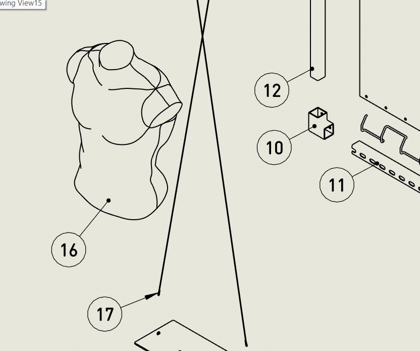

Hello, Is it possible to remove the tangent edges for individual components in a drawing view?
I'd like to turn them off for item 16:

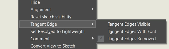

...I know I can change the Tangent Edge display for an entire view:

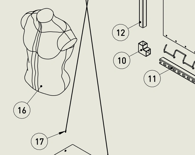

But that make items 10-12 look wrong:
Per component control would be extremely handy, so any tips will be gratefully received.

Not that I can find.  You can change the component line font to dashed, or maybe, create a new line font that works and assign it.
DM
DM 2025-07-03
It is a very tedious process select each line you don't want to see and then click on the command in the picture
comment imagecomment image
JS
JS 2025-07-03
Use the Hide/Show Edges tool.
MA
MA 2025-07-03
Thanks for that, it is indeed very tedious process when it affects several components and views. It would be extremely useful to have more control of part appearances in within assemblies at drawing level.
JS
JS 2025-07-03
Can you upload the mannequin model?  Perhaps it can be tweaked to eliminate the bothersome edges.
MA
MA 2025-07-07
Hi Jim, That's a great idea, thanks! I've uploaded the SW file which is just an imported body from some long-forgotten original source.  Let me know what you think can be done with it.
