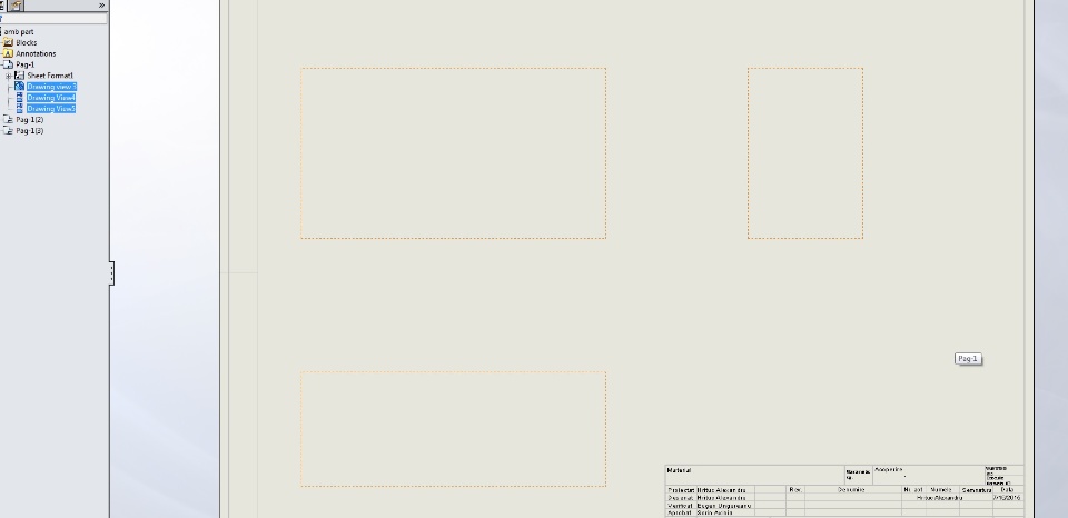

Hi,
How can write a code to select from design tree all drawing views from active sheet?
Thanks,
SolidworksApi macros
Answers 2
DG
DG 2015-08-20 Best Answer
<p>Option Explicit</p><p>    Dim swApp                   As SldWorks.SldWorks</p><p>    Dim swModel                 As SldWorks.ModelDoc2</p><p>    Dim swDraw                  As SldWorks.DrawingDoc</p><p>    Dim swView                  As SldWorks.View</p><p>    Sub main()</p><p>    </p><p>    Set swApp = Application.SldWorks</p><p>    Set swModel = swApp.ActiveDoc</p><p>    Set swDraw = swModel</p><p>    Set swView = swDraw.GetFirstView</p><p>    </p><p>    While Not swView Is Nothing</p><p>        swDraw.Extension.SelectByID2 swView.GetName2, "DRAWINGVIEW", 0, 0, 0, True, 0, Nothing, 0</p><p>        Set swView = swView.GetNextView</p><p>    Wend</p><p></p><p></p><p>End Sub</p>
HA
HA 2015-08-20
Thanks Deepak
