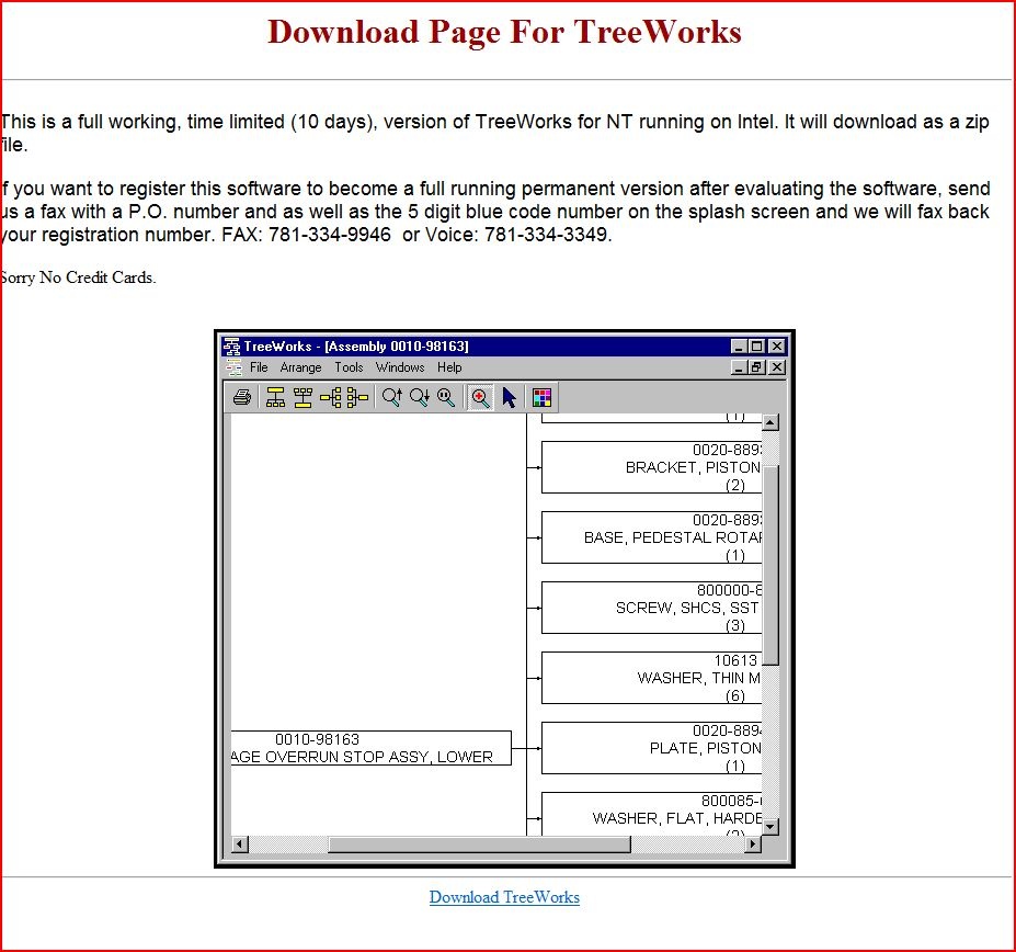

i discovered treeworks but looks like it only runs on NT! have anyof you used this software?SolidworksDocumentation, Certification, And Training

David ... Why do you believe it only runs on NT? I seenowhere on the site (http://www.deltagl.com/) whichstates that.
NT programs should run OK on XP, and if it won't run on Vista, youmay be able to run it under compatibility mode.

hi kelvin,
looks like i had found a link to an old website foir this site yousent me is very different.
have you any experience usingthis software? seems like SW shouldacquire some technology that provides this functionality. managerssign PO's and managers like to see their project displayed in anumber of ways, one of them is drawing trees. adding thiscapability would surely only help to sell the mamnage on upgrades.
i am gonna try it out...

when directed to the download page, this is what comes up...ihave a call into them to get the skinny...
