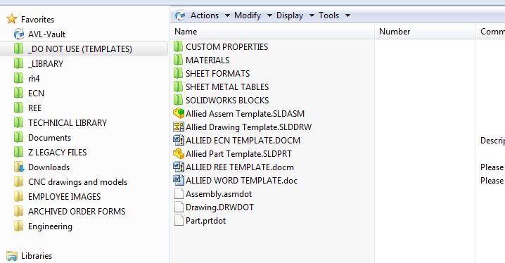

I have added our three templates to our Vault.

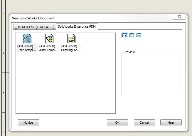

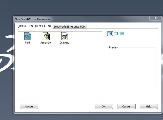

When I start SW, the system then creates Part, Drawing & Assembly copies in a local folder. As far as I can determine there is no way around this. For this reason after much head scratching I called the templates folder DO NOT USE (TEMPLATES) to try and push our guys away from using these templates files (They do not pick up the datacards and hence serial numbers)
The part and assy templates in the Vault work fine. The drawing template was created with units MMGS. When I create a SW drawing using the system created template (drawing.drwdot) it remains MMGS. However when I use the vaulted template (Allied Drawing Template.slddrw) the units are set to IPS. This is a bit of a pain as we always use metric. I have pretty much exhausted everything I can think of. Anyone else encountered this problem or have a solution? I have attached some screen dumps.

There are a couple of things going on.  The part.prtdot, assembly.asmdot, and drawing.drwdot templates are getting added to your DO NOT USE (TEMPLATES) because that is the only template folder location you have listed in your System Options and SolidWorks has to have access to some template files so it adds the default ones.  If you add another folder on your network (not in the vault) with some SW template files in them and add that location to your system options, they won't be added to your vault.  You can call that folder DO NOT USE if you like but there has to be at least one folder listed in the Drawing Templates that has actual template files..
As far as the EPDM drawing template is concerned, you need to use a template variable for the part number in the file name (in admin template screen dump 2).  You don't have anything set up to copy the part number to the drawing file name.
