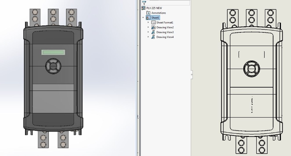

drawing looks nothing like model
Please see attached images.
I have a display on the front cover and its not drawn properly, secondly there's some wired artifacts in the middle of the front cover that i cant get rid of.
could someone offer some advise as to how to retain the details of the display and to get rid of the wired artifacts.
thanks in advance

Check to see if you have any sketch's left as visible. Can you upload your part?

You have a bleed through Graphics issue, some settings to possibly adjust - does it show like that when you print?

Here's what I would try.
1. Ctrl-Q rebuild on the drawing.
2. Change the drawing view from HLR to shaded, then back to HLR.
3. See if your graphics driver needs to be updated.

You views are not fully resolved...note the feather in the feature browser.

strange tried everything....
gave up, now I've come back to it, it's ok
the unresolved issue is just some mates
