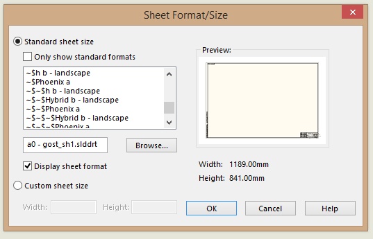

I was recently trying to incorporate a customer's logo on a drawing fromat. I've done this before with no ssues. For some reason SW wouldn't accept the picture (jpeg) I triad a few time, well more than a few, im stubborn and gave up and made the sheet format without his logo. No big deal really. Here's my question. Now when I start a new drawing and pick a sheet format they are all there but there are other empty formats there as well. they start with ~\\\$. How do I get rid of them? I looked in the directory where the formats reside but they dont show up. I thought they might be hidden files, they weren't. It's not a big problem but it annoys me. Does anyone know how to purge these things.

I would first check your options for where it looks for formats (Options / System Options / File Locations / Sheet Formats) then check the contents of those folder(s). Delete all the ones you don't want.

Thanks Dwight but those files aren't in there.

I know you said that's not temporary files, but it sure looks like it is.  Have you re-booted since that started?

They may be temp files but if they are I can't find them. I did a disk cleaup and rebooted and they're still there. After that I wrote this post looking for help.
If no one can help me I'm going to contact my VAR, they've helped me a lot in the past. I do pay for the service but they very good, Fisher Unitech. I didn't want to bother them with a nuisance thing if I could avoid it.
I'm not having trouble with any imported logos except for this one client. I lifted the logo from his website. Even though it's a jpeg maybe there is something embededed in it relating to html code. I'm not that familiar with that sort of thing.

I fixed my own problem.
1. In Windows File Explorer I made a new directory sheetformat-1.
2. I moved all the sheet format files from the sheetformat directory to sheetformat-1.
3. I deleted the original sheetformat directory.
4 I renamed sheetformat-1 to sheetformat.
Trash files are gone, sheet formats open fine and I'm a happy camper . If anyone else encounters this problem I hope my solution helps.
