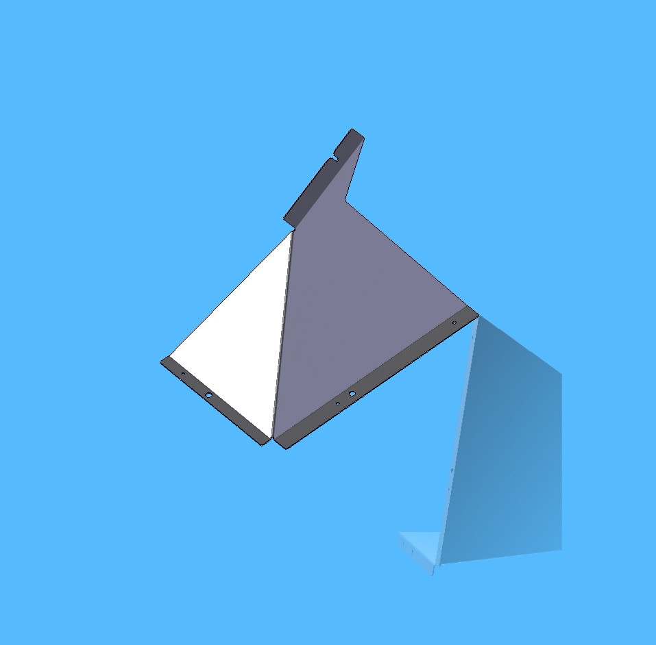

Drawing Error - sheet metal geometry too complex.
I am using SW2011 with SP3.
Unfortunately, I cannot post this part due to proprietary reasons but I am hoping for suggestions on where to look.
I have developed a sheet metal part. The part has no errors. The drawing for the part including the flat pattern has no errors. I exported the part with Save Bodies to create a water jet flat pattern. The exported part and its drawings have no errors.
I also mirrored the original part to make an opposite handed version. In the mirrored part I converted to sheet metal so that I can derive a flat pattern. This part has no errors and the part will flatten.
I created a drawing of the mirrored part. The flat pattern view in the drawing causes the error "The geometry in the bend region is too complex."
What is interesting is that the Convert-Solid feature in the part file itself does not throw an error. But it does when you expand the feature tree in the drawing.
This is not a particularly complex piece of sheet metal. It is, however, complex in its derivation. None of the bends are at 90° and it is created with references to several other parts of the assembly.
Not quite sure where to look since it falls apart somewhere between the part file and the drawing file. I have another sheet metal part that is built in exactly the same manner - mirror and all - with different dimensions and it works fine. If anyone has suggestions for typical areas I should look at I would appreciate it. I have changed the bend relief notches as a first attempt.

Some additional observations:
I recreated the mirrored part from scratch and carried it all the way through to a drawing without errors. What I noticed is that in the problematic part, there is a configuration under the default config associated with a flat pattern. If I click the flatten button, this configuration does not become active. If I activate it manually, the error seen in the drawing also appears in the part.
I tried deleting the flat pattern configuration - SW wouldn't let me. I tried deleting the convert to sheet metal features so the only thing in the feature tree was the original mirrored part import. SW still would not allow me to delete the flat pattern config.
In the newly recreated mirrored part there is NO flat pattern config before the convert to sheet metal is performed.
I think if I could delete the problem config in the original mirrored file and then have it recreated by converting to sheet metal again it would fix the issue. I would like to salvage the old file because of vault checkin history and all the mates in the top level assembly. Any thoughts on what is keeping the config from being deleted?

One reason you are not allowed to delete a config is if you have the drawing open that uses it.  Sometimes even closing that drawing does not release it from the memory, you have to close SW and restart to get it to delete.
In the normal course of things, the flat pattern config is created by SW when you add the flat pattern view to a drawing.

Give that man a Cigar!
Thanks Wayne. Sometimes you get so bogged down in details you completely miss the obvious.
