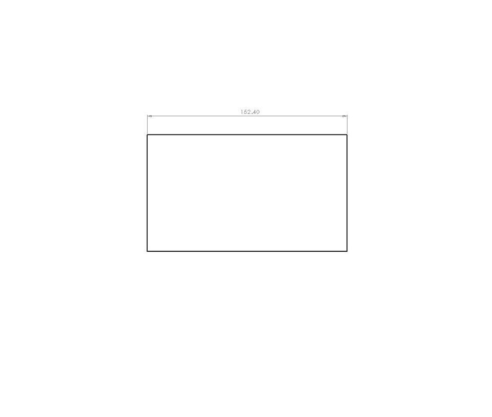

Hello all,
I need help with this one i am trying to set drawing dimension tobe driven but my dimension property for read only is checked andgray out , i can't select driven.
basically i want to change dimension from drawing and the modelwill update how do i do that ? see file attached.
Thank you allSolidworksDrawings And Detailing

Instead of placing the dimension yourself you need to let SWplace the dimension, to do this Insert -> Model Items

Thanks Troy, i know that method , but sometimes i need to putdimension from drawing that not on the model. Do you know the wayto link this back to model.

Calvin,
The only way this is possible is to create the dimension in themodel, whether it is driving (model) or driven (reference).

JB 2009-02-27
There is none. It is not possible. You can't have a fullydefined model and then go back later and add some drivingdimension. Do you understand parametric modeling?
