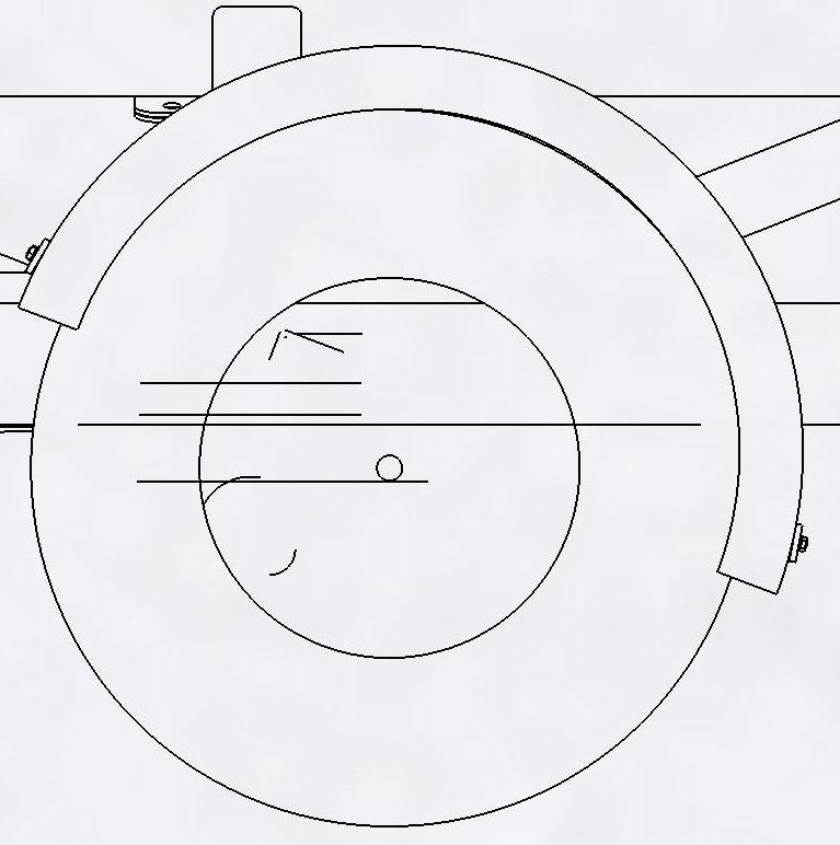

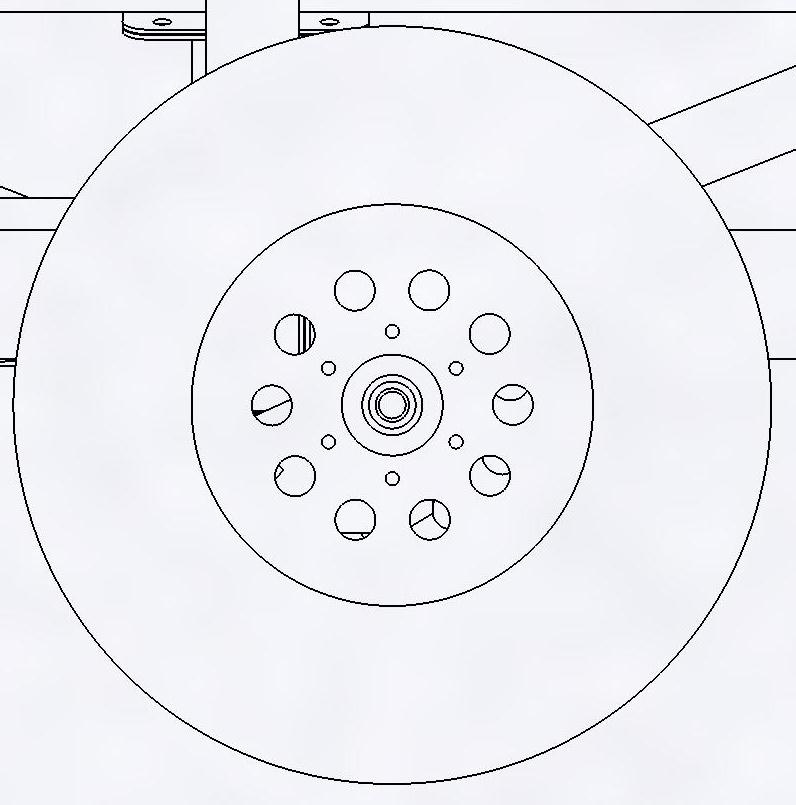

Hi All,
I have a drawing that is giving me fits.  In the drawing view the detail of the tire is lost and it shows lines that should be hidden behind the tire (see attached TIRE.jpg).  If I change the view to an isometric or trimetric view it shows up correctly (see attached TIRE2.jpg).  When I go back to the front view it shows up correctly for a split second then goes back to looking like the TIRE.jpg.  I have tried turning off "Large Assembly Mode" and changing the image quality in the document options, nothing seems to change it.
I know that this worked in SW2007 from the old copies of the drawings.
Does anyone have any ideas on what to change?  I would appreciate any help.

Hi Scott,
Thanks for the reply.  The display state is the same for both the front view and trimetric view.  If I change the display style to shaded it looks correct.  When I go back to hidded line removal, it shows correctly for a split second then gets screwed up again.
It looks the same when I have somebody else open the drawing but we all have pretty much the same settings since we just went to SW2011.
Control "Q" has no affect.  What does that do?

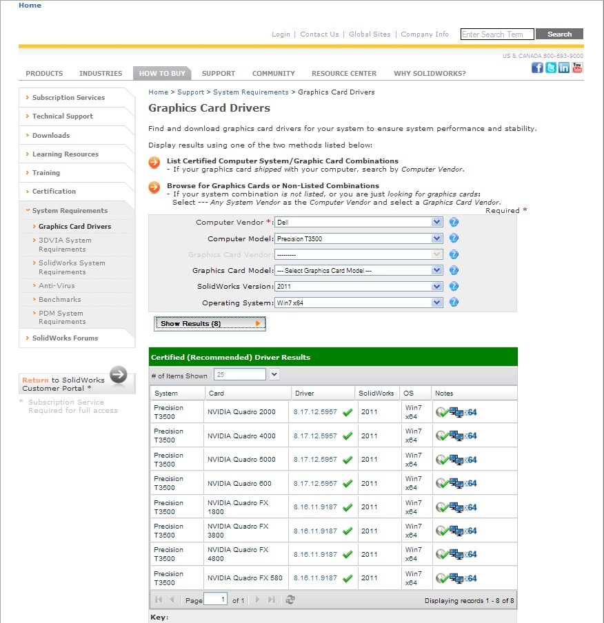

Check on the Solidworks forum to see if your video card is compatible.
Also see if you have the latest driver.

Depending on which grahics card you have, you should be using one of the following drivers.
If you don't see your card there, you may have to go to the nVidia site and try one of their newer versions.

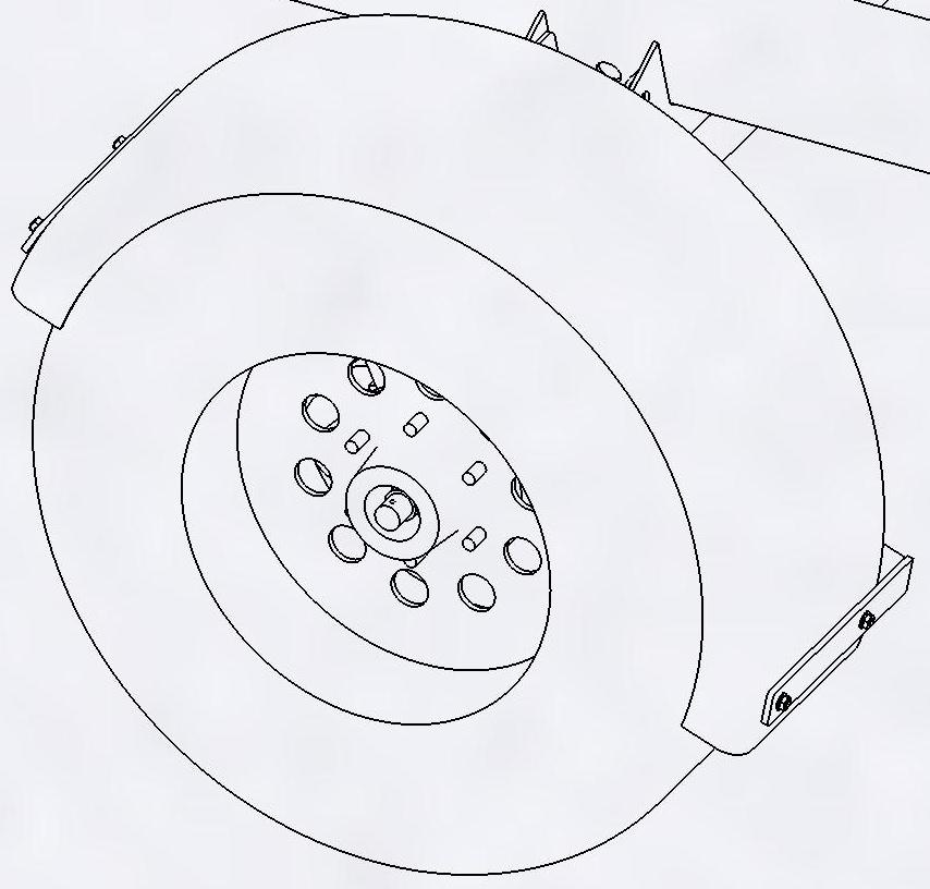

JW 2011-02-17
I just found the problem.  There was a shell feature and a fillet feature in the tire model.  This was not done the way I would have done it, but that's another story.  The shell feature is 1/4" and the fillet is 1 1/2".  I did some testing and found that when the shell feature was changed to 1 1/2" the drawing showed up correctly.  But if the shell feature was changed to anything less than the fillet feture then it had the problem shown in the pictures.
Luckily the shell feature can be deleted because it has no bearing on what I am doing but maybe something SW needs to look into.
Thanks for everyones help.  I have attached a picture of what it was supposed to look like.

JW 2011-02-17
The model is one part.  There is a revolve to get the outside dimensions of the tire, then a revoled cut to make the wheel hub faces that are leaves 1/4" for the hub and cuts the center hole.  The shell was after these two features and was 1/4".
