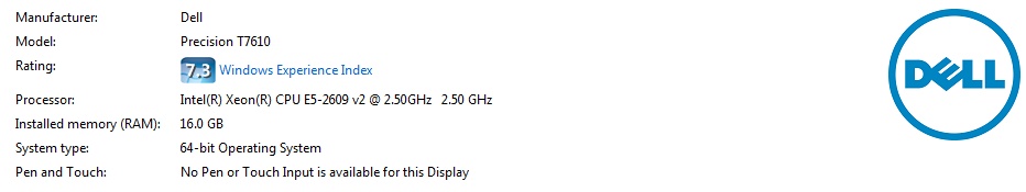

Hi ,
Im having an issue with a few drawings of mine.
The drawings for which I have this issue, takes 25min to open.
When my drawing eventually opens it gives me an error stating , that there was an error whilst opening my drawing and that I must consult my VAR; The problem is that after ive closed the error message I am left with my drawing sheet and it will not zoom in or out , although the ruler shows the result of the zoom ,the actual sheet is stationary.I can however click on all the tool etc, it is almost as if the drawing sheet has become a mask and I am working behind it ,blind.
Now my VAR , said that he believes the drawing to be corrupt.
On further investigation I found this to be false as it opens up just fine on another machine(same spec machine + same drivers ).
PLEASE HELP !! this drawing took me like 4 hours to do because of the computing time for the sections.
Before anyone bashes my set up , I am on a more than proficient PC,
My model just has alot of unique parts , sometimes 40k Parts
THANKS

Since you said it opens fine on another machine I'd suggest opening it on that machine and do a Pack and Go to a new location, then see if you can open the new file.  Also, have you shut your computer down and re-started it since this happened?

Try creating a new windows profile on your machine and opening it with that profile.
I've heard here on the forums (and had it happen where I work) that a corrupted windows profile can cause issues.
It's relatively easy to do and you can delete it if it doesn't work.
Also, try the SWRX route of opening with software OpenGL (just to try) and open bypassing all SW options.

Maybe it has something to do with the SW system settings, like certain template paths or something. I'd try temporarily importing all of the settings from the other machine and see if that fixes it.
