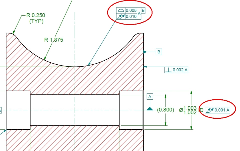

Drawing annotations explained?
I am no machinist so I have no clue what these mean exactly. I'm assuming they are denoting a surface finish but am not sure. I'd like to know the symbol meaning and letter designator at the end. The dimension is pretty obvious. I have circled (kinda) the annotations. The drawing is from a company in England if that make a difference.

AW 2015-05-05 Best Answer
Those are GD&T annotations defining surface profile and runout to datum A and B.

JM
JM 2015-05-05
Find resources relevant to Geometric Dimensioning and Tolerencing (GD&T).
A and B are datums with A being the primary datum.
The double arrow is runnout permitted relative to datum A (the axis of the part).
Edit: Yeah - what Anna said.
