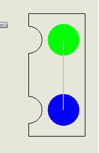

in our old AutoCAD prints we used solid color coded circlesto mark thing in the drawings. occasionally we would need to join 2circles with a line.
we made blocks of all th e colored circles we use, but when we tryto us a line to connect them, of course, the line is "under" solidhatch of the circle.
any ideas on how to get a line to show ontop of solid hatch?

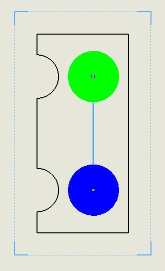

OK - lets see if this worked.
If the picture get attached, you'll see colored circles with a lineconnecting the centers of particular pairs.
when we try to recreate this in solidworks, the line gets put"under" the solid hatch. making it very easy for the assemblers tomiss - especially since they are used to seeing the hole line.
so far our work around involves a felt tip pen and a straight edge- we need something better.

MK 2009-07-07
After you get your circle blocks and lines in place, rmb onthe circle block and explode them. Once the circle and hatch are nolonger a block, you should get the result you need.

Steve - the earlier pic is an AutoCAD screenshot.
thanks Mark - the explosion seems to work. though it seems torequire that we explode both blocks at the same time, which strikesme as very weird, but workable.
