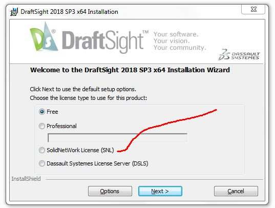

Draftsight Network Install, Licenses Served Up On SolidNetWork SNL
Can Draftsight Network licenses be served up and controlled by the SolidWorks SolidNetWork SNL?

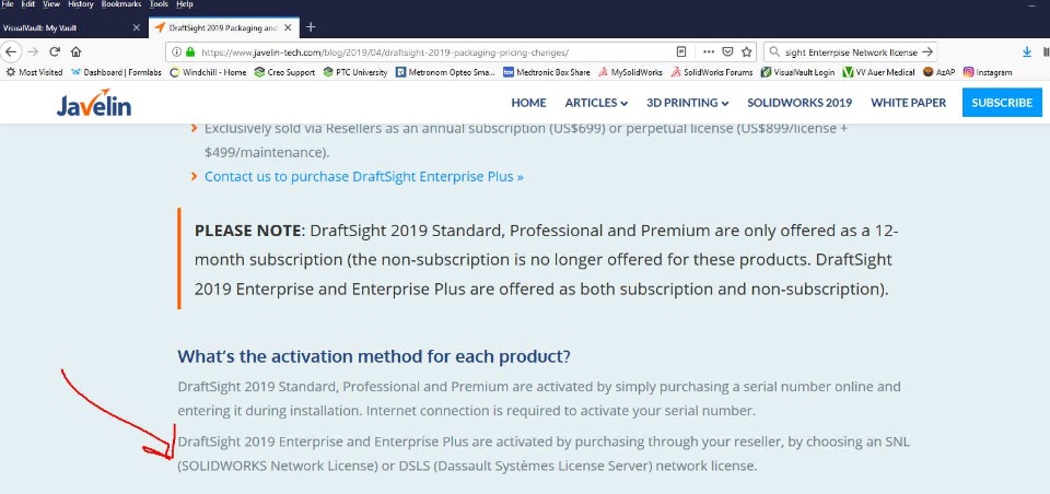

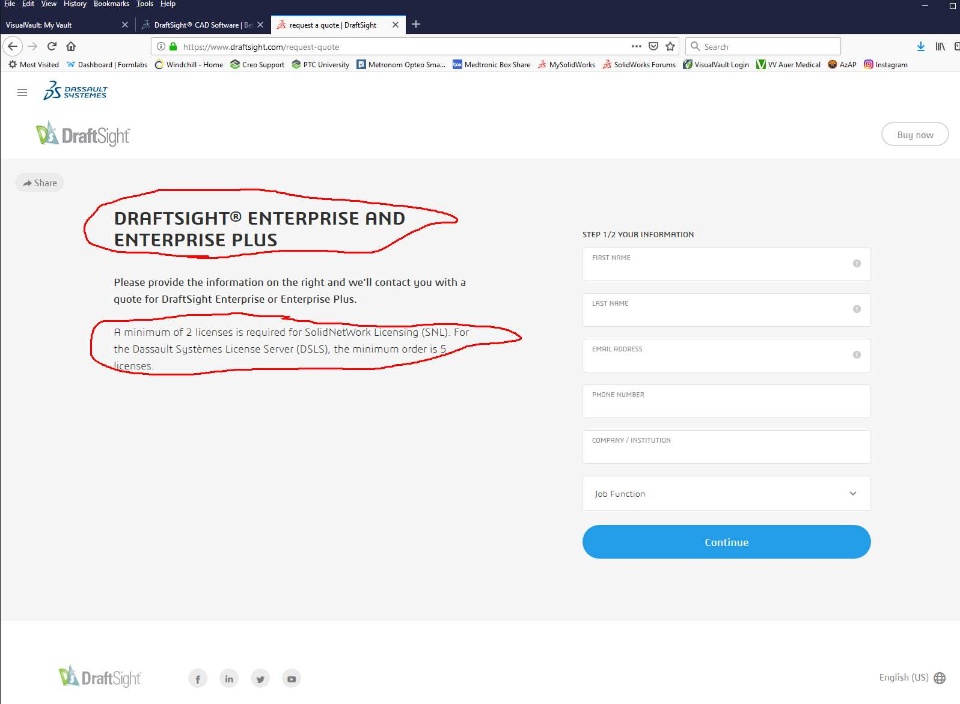

DS's website for Draftsight says it can. Javelin-Tech says it can be done. The Draftsight install says it can be done.
My interpretation is that I would only have one instance of an SNL running and it can control my SolidWorks seats and Draftsight seats. My Draftsight seats would be added to my SolidWorks serial number. I would not have a separate serial number or license file for Draftsight.
What say you....
