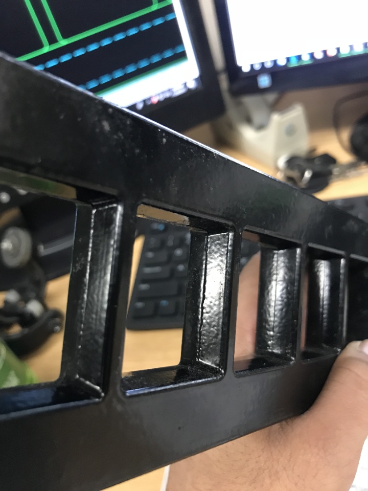

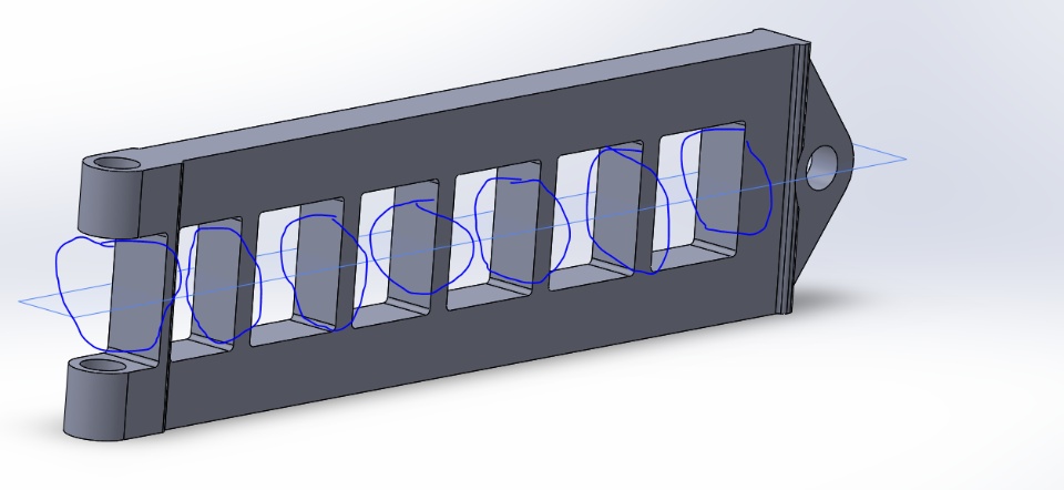

I need help creating a 5 deg draft on this aluminum casting link.
Blue circles represent the location of the draft,... see actual picture of the draft on the slots..
I've also attached the part file for you guys to try, Thanks!

I'd start with a solid 'bar'. Sketch seven squares on one face of it. Extrude-Cut with Draft applied. Then Mirror the extrude-Cut, or reproduce it manually on opposite side. Finally, make a non-drafted cut on your hinge forks at the one end if those don't include same draft.

Hello,
  1. Create a midplane plane
  2. Using the midplane, do an intersection split all around your pockets (I only show 3 faces but select all four and the four radii):
    TIP: After selecting your Plane for the pink box, SW doesn't tab into the blue box, so click in the blue box, else your face selection will go into the pink.
  3. Do an intersection neutral plane draft on each side of the split.
Repeat for all of the pockets.
Fillet as required.
Cheers,
Kevin C.
If I'm seeing the piicture correctly, I think you'll need to remove the corner fillets in each opening, do the above and then fillet afterwards,
Drafting the fillets as above turns them into cones which isn't realistic for a core.
Filleting afterward, I believe will generate a cylindrical radius.

You can add 5 deg when in the cut feature - see below image
Edit: Opp.. sorry ... you only want to add draft on one side - then you need to use draft feature. But best to remove fillet on your sketch and apply it after draft

Hello,
Along the lines of Mr. Chu's post
  1. Move my midplane above the Extrude-Cut for the openings
  2. Change the Extrude-Cut sketch plane to my midplane
  3. Change the Extrude-Cut to midplane
You can then use the draft option of Extrude-Cut to satisfy the OP
(As I stated above, for a more realistic corner draft, the cut sketch must be modified to remove all corner radii, then fillet after the draft.)
