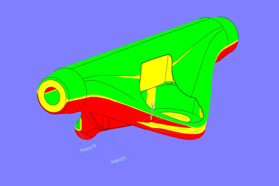

I'm currently a student and still learning the software. I have developed a design but the draft angles show problems if it were to be casted getting it out the mold. is there a way to quick fix this? plus what does it all mean, I know yellow is the areas that need addressing but it is all a little confusing especially where there is a cut extrude circle through the top, how would I fix that do I need to loft everything?
I am basically looking for help because i know changing one thing will most likely mean several other features will fail, thus causing me to start again.

you should be able to use the draft feature (on the features command manager tab) to apply the required draft to the model rather than trying to modify each of your features to model the draft as you build the model.

However I have done that on all the parts I can now but some elements of the design is does not allow me to do this leaving me with
comment imagecomment image

You may also need some side actions in your mold.
Can you attach your *.sldprt file here?  (Use Advanced Editor - upper right corner of Reply box, then Attach.)

The draft analysis will show a yellow edge on a cylindrical part.
The yellow area in the Cut-Loft4 could be changed to add draft all around by removing the scallops, unless your design requires them.
For molding this part, the wall sections should have less variation.
There is a gap between the loft6 and the main body which is preventing the formation of a single solid.

Areas which I call scallops.

I was able to use the intersect to combine.
I first tried combine, but that failed.

Nice part!  If you are intending this to be an injection molded or casted part and you want to do it with a basic two part mold, then you will have to redesign your part, feature by feature with the partline in mind.  In other words, now that you've designed the concept, you need to design for DFM (design for manufacturing.) If it is not a simple two-part mold, you can start to introduce multiple slides in the tool thereby increasing it's complexity and cost.

When doing Draft Analysis, be sure to click the "Gradual Transition" box, and then make sure the color for negative draft is Blue.  Then look for Red areas, they will be the areas that have Zero draft and will need attention.  A thin red line going around the part is not a concern, it is just where the parting line will be.
