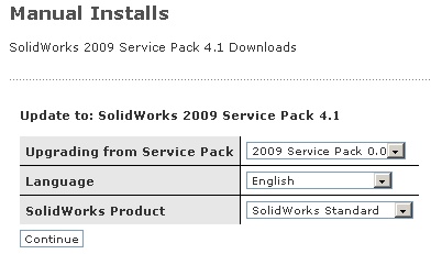

Did you tried here for downloading manually and sorry for that broken link though it works here.

thanks, you are correct.  I had gotten to that link, but gave it up as a dead end. it was VERY misleading link since it forced me to pick an upgrade from an earlier service pack in order to get there.  I don't want an upgrade an earlier service pack of the client, but an actual full install of the license manager.
thanks again for your help, you solved it for me!!!!!!!
