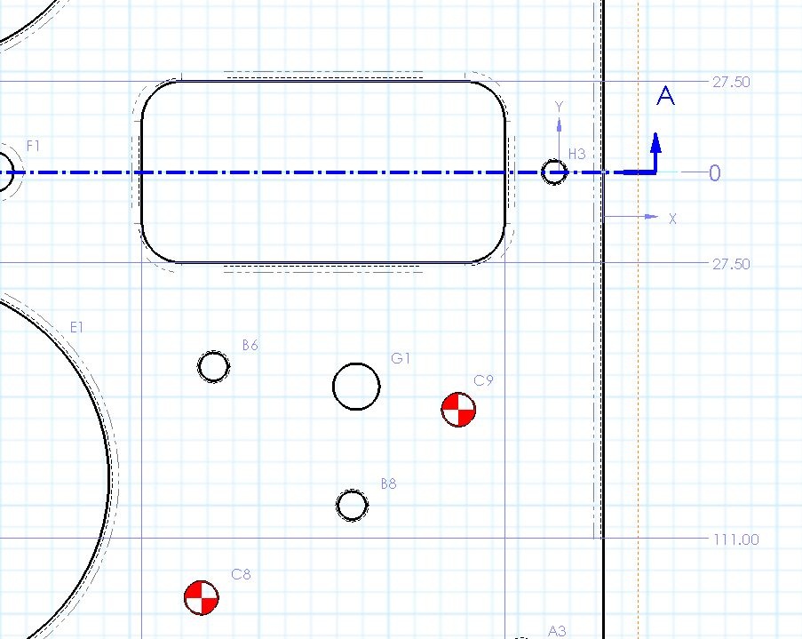

Hi,

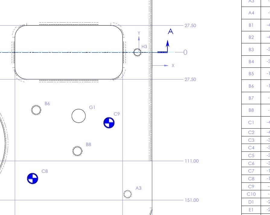

When I have a drawing with a section line, (shown with a thick line and Thin/Thick Chain linetype), and a dowel symbol; then save as a pdf, the dowel symbol adopts the lineweight and colour of the section line.
When I change the type and/or colour of the section line then the dowel symbol adopts that specific colour and lineweight when the drawing is saved to a pdf.

I am using layers to assign colour, linetype, and lineweight.  After a sketch line is converted to a section line the icons in the line format toolbar are greyed out upon selection of that section line so I am not able to change the section line.

OK, this is what I have tried as a workaround.
In the same view as the dowel symbols I have created an extra section line and then hide the new, unwanted view.
I then select the section line itself and put it on a layer that has the properties that I want the dowel symbol to have, (in my case, red, plain line, thin line).  Then I drag that section line, (by grabbing one end, then the second end), and place it off the page completely.  Next I save as pdf and the dowel symbols adopt the properties of that extra section line.
