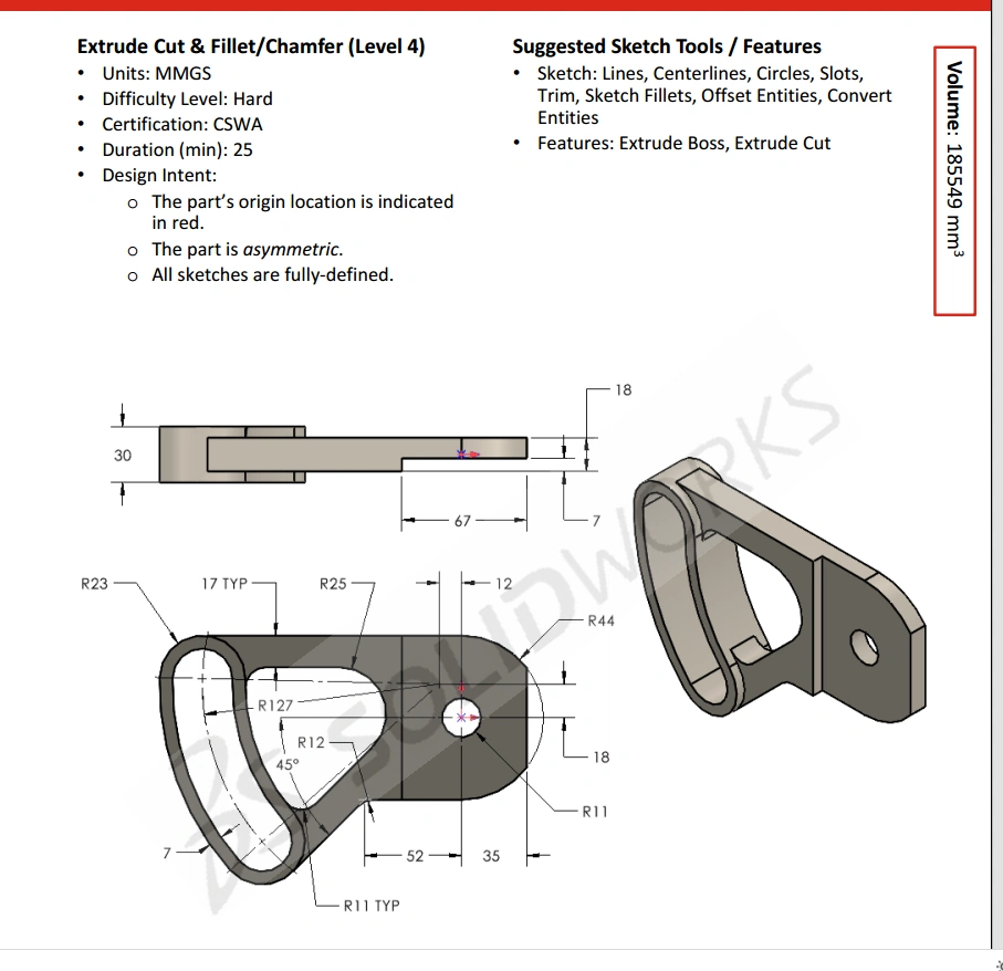

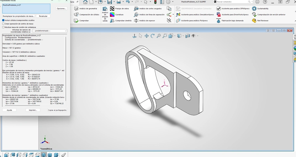

Doubt about the result of practice 4.27
The last few exercises I've been doing are giving me an error margin of between 0.5 and 0.8, and I'm not sure if that's normal since I can't compare with other users. In this particular exercise the error margin is higher than 0.8, and after checking the sketch/croquis I don't see any difference, so I'm not sure if there's some kind of mistake/failure in the system. Does anyone have the same result as me?

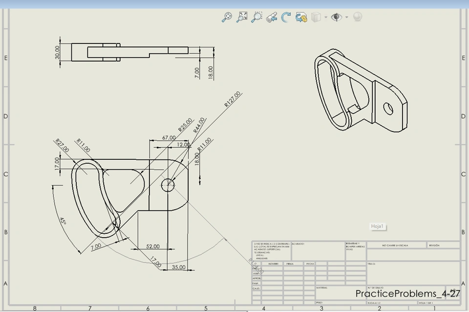

it might just be graphics, but your drawing looks a little off. The top of the part in the front view does not look flat.
Maybe look at the sketch and confirm you have the constraints set.

Your model is not looking correct to me. Can you share your model to check. Make sure to save the file in the lowest version possible.

I see two mistakes in your model.
EH
EH 2026-02-18
Just going by your first pictures - it looks like you missed the 12mm radius on the bottom of the part.
I know it may not be part of the exam, but why are the dimensions so sloppy on your drawing? You might catch more of your mistakes if you try and match the placement of dimensions on the assignment.

I just opened your part and I get a different volume, about 0.08% off

[en] this should be horizontal, or i am wrong ? => Rep:1
       Not axe rep 2 . (angle)

With the 2X R11 corrected, as per Mr. Sculley's reply, I get 185179.47 mm^3, which is 0.002% less than the practice answer.
GF
GF 2026-02-18
Finally, the problem was the error with the two radii that were 11, and then the PDF is also wrong

I will have to agree with everyone else, the Volume on the PDF is incorrect.
